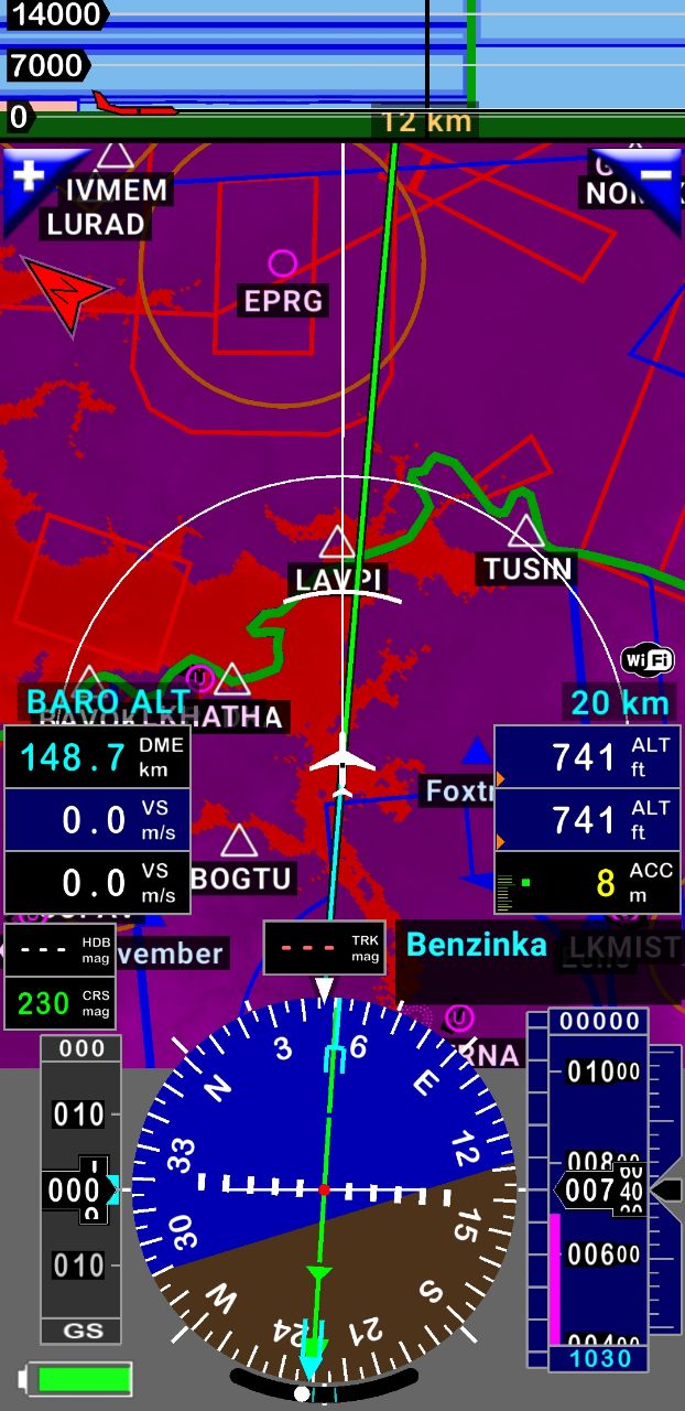

Yes, since version 22.10 it is possible to connect Fly is Fun with the Stratux
- Airplane broadcasting ADSB out signal detected with the Stratux are displayed on the Moving map and on the elevation/terrain map
- Stratux AHRS module is used to and display in the compas of the 2 instrument screen as well as on the elevation/terrain map
photo_2019-05-16 15.09.42.jpeg (141.63 KiB) Viewed 14409 times

Anyway:
- The artificial horizont is displayed only when Stratux has GPS fix.
- You can calibrate AHRS by long pressing the slip indicator at the bottom of the screen.
