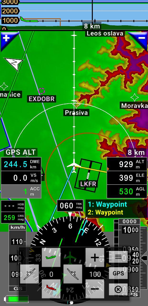

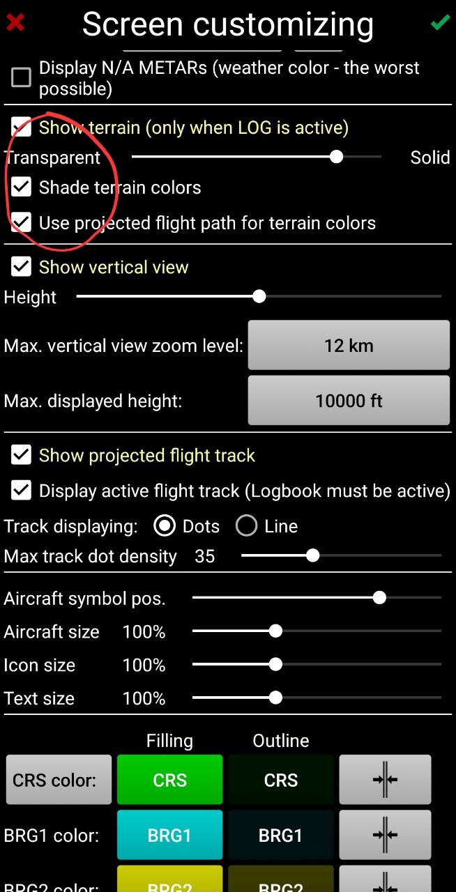

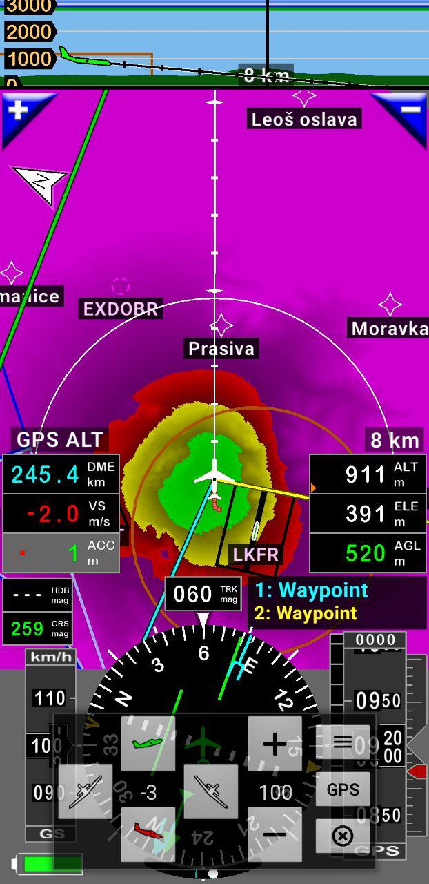

Anyway, you can switch-on "Use projected flight path for terrain colors".
- At terrain or map screen Customize screen (long tap compass rose)
- Check "Use projected flight path for terrain colors"
I add 2 pictures. One is in level flight, second is when aircraft is descending...
Descending
Level flight

Postby kitercuda » 02 Jun 2023, 09:04
FIF has a glide advisor based on real data several years :)
You must set screen as at attached picture.
It is working only when LOG is active...
Look at the video FIF_terrain. I show a simulation flight. You must unzip the video file before playing
You will see how terrain is changed if you climb or descend.
FIF_terrain.zip
