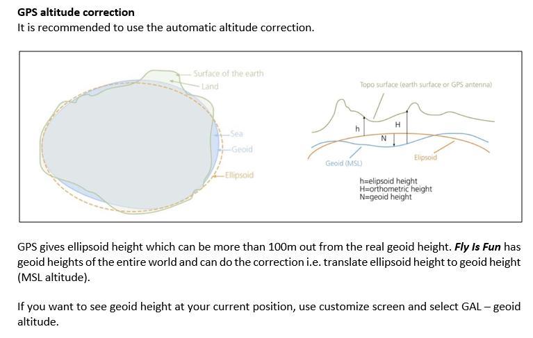

Postby kitercuda » 30 Sep 2020, 14:10
Try this:
Menu / App settings / Preferences
Internal sensors settings / GPS / Altitude correction and uncheck Automatic correction
This is the correction between GPS altitude and the geoid. Sensors from some devices give already corrected altitude.
The picture is from user guide...
