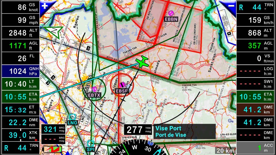

The map is correctly displayed if "North Up" or "Track Up" is selected.
However, selecting "Course up" produces a strange result (see snapshot)
This happens when navigating with a Goto (no route).
FIF_2019-09-08_Course up - wrong map orientation.png (706.15 KiB) Viewed 5928 times

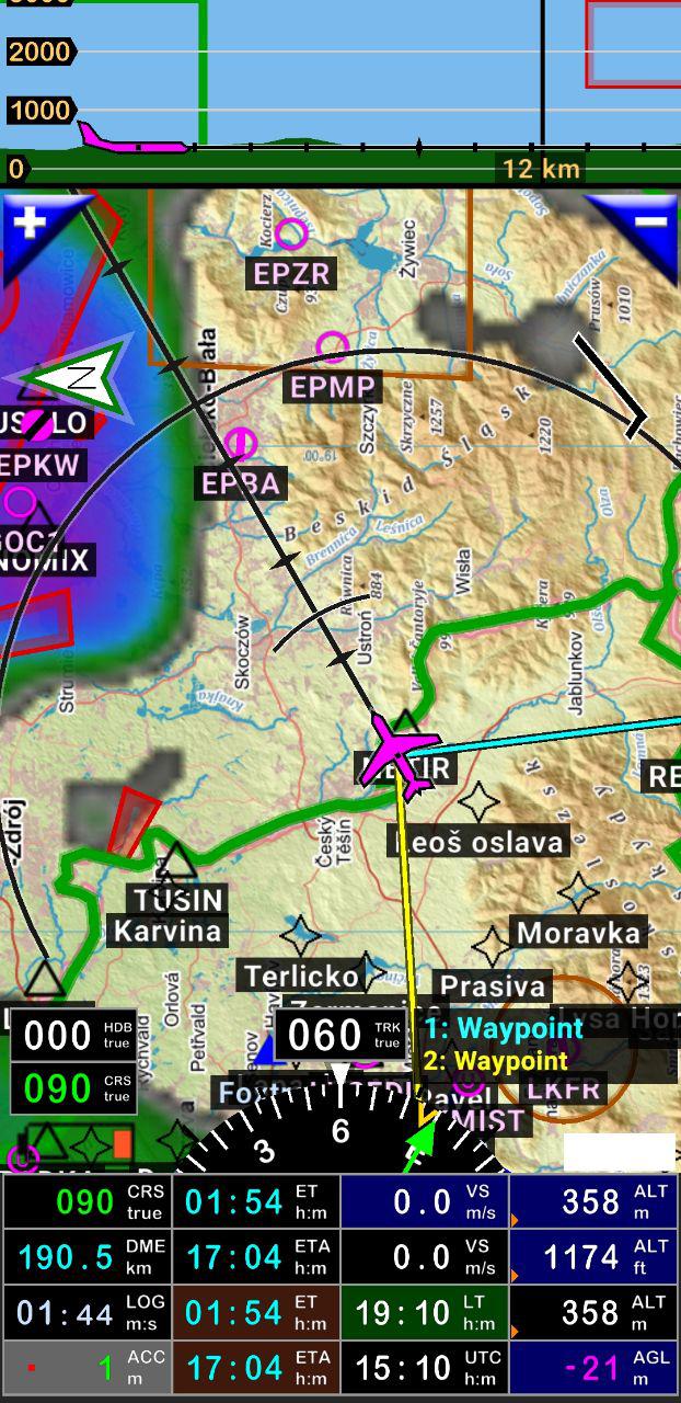

What you think, is it ok at my picture?
TRK = 60
CRS = 90
(As you can see at value windows)
Re: wrong map orientation with "Course up" selection
Postby RogerF » 09 Oct 2019, 17:43
Understood!
The orientation is based on the selected course, not on the direct route to the goto target.
Respecifying the goto target can be used to reset the CRS in sync with the Goto.
OK, just a misunderstanding of mine.
