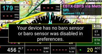

The latest version has foreseen a manual QNH input to benefit of the AMSL <==> FL conversion, even without pressure sensor.
Unfortunately, I was not able to use it.
Here below the error message when I make a long press on the FL button/display.
I checked the options several time, but could not find the option mentioned in the error message, probably because I do not have a pressure sensor.
:roll:
Screenshot_2019-05-31-12-58-44-012_gps.ils.vor.glasscockpit - manual qnh problem.png
Screenshot_2019-05-31-12-58-44-012_gps.ils.vor.glasscockpit - manual qnh problem.png (70.67 KiB) Viewed 8529 times
Re: manual qnh input
Postby Frank » 04 Jun 2019, 20:21
Same to me, and I'm also interested in what's going wrong.

Postby kitercuda » 07 Jun 2019, 20:46
Sorry - version 22.23 solves it. Just published...

Postby RogerF » 09 Jun 2019, 18:19
QNH input problem is indeed solved in the latest version.
Thank you for the correction.
