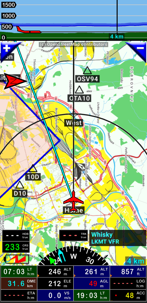

I had a look and it should be OK. I tried to display log - we have mag var around 5. Mag var is calculated...
2019-02-17 18:57:54.557 8104-19668/gps.ils.vor.glasscockpit D/AAA: Mag heading = 265.89578
2019-02-17 18:57:54.557 8104-19668/gps.ils.vor.glasscockpit D/AAA: Map heading = 270.64215
A made 2 screenshots. One with FIF set to display true directions and second one to disply magnetic directions. Map is always true. It seams to be OK. Can you send me your screenshot?
At the map you can see WPT called West. it is exactly on radial 270 (true) from my place.
