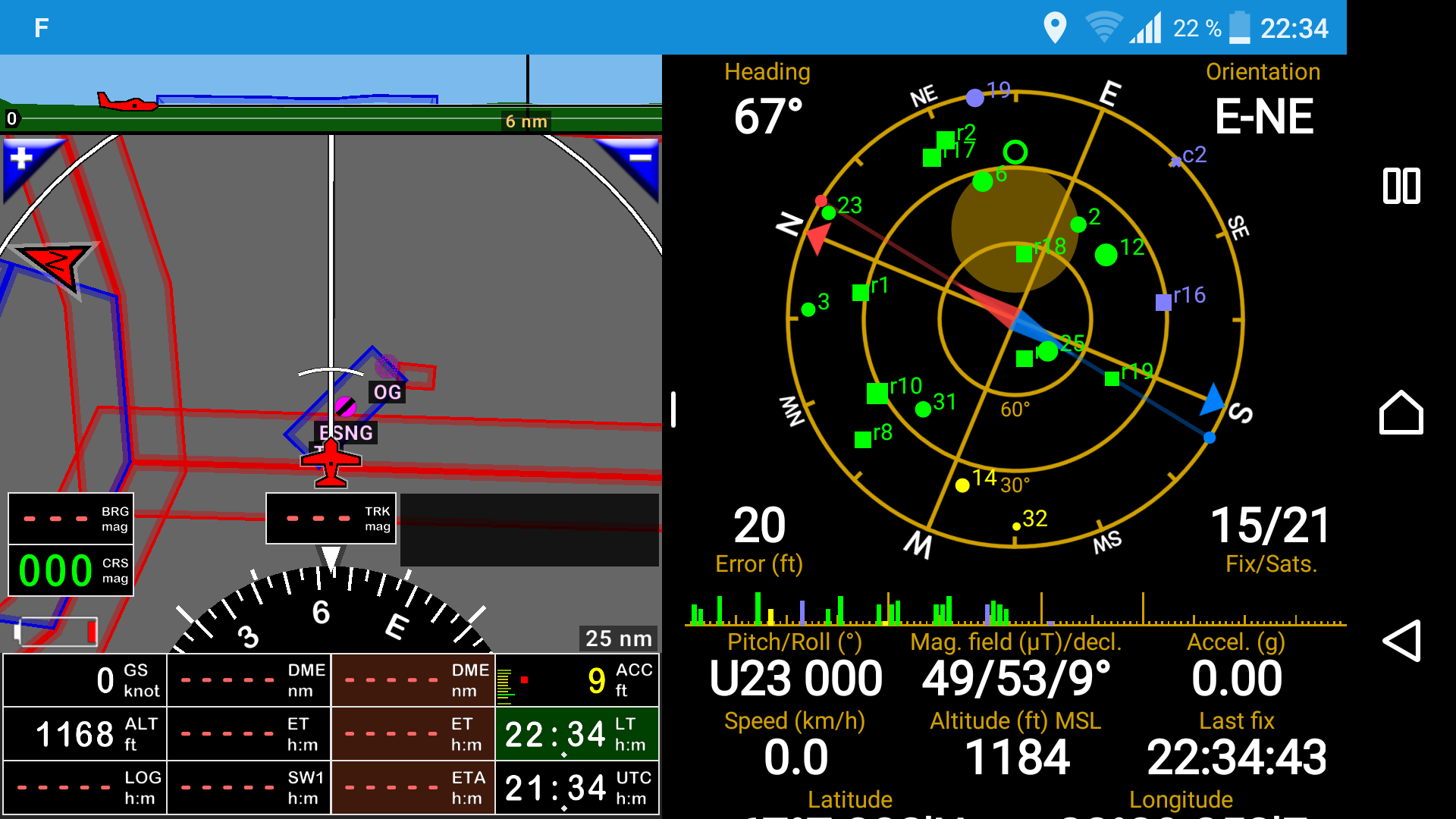

Postby Holton181 » 01 Oct 2017, 09:58
Just noticed that, on my unit, the GPS acc has the unit in feet (ft) but the number is in meters.
I saw that I got a acc of 3ft in FiF while the best I ever got before with other apps is 3m.
So I compared with 'GPS Status' and 'Oruxmaps' and indeed got an acc of 3m, changed units and got 10ft.
I could even see the acc of 'GPS Status' in the Android status bar while I had FiF running, same numbers (3) but different units.
BR
/H

Postby Holton181 » 30 Dec 2017, 21:41
Thank you for your answer.
Yes, according to the code you are showing fif really grabs the accuracy both as meters and (calculated) feets.
But how are the variables used later?

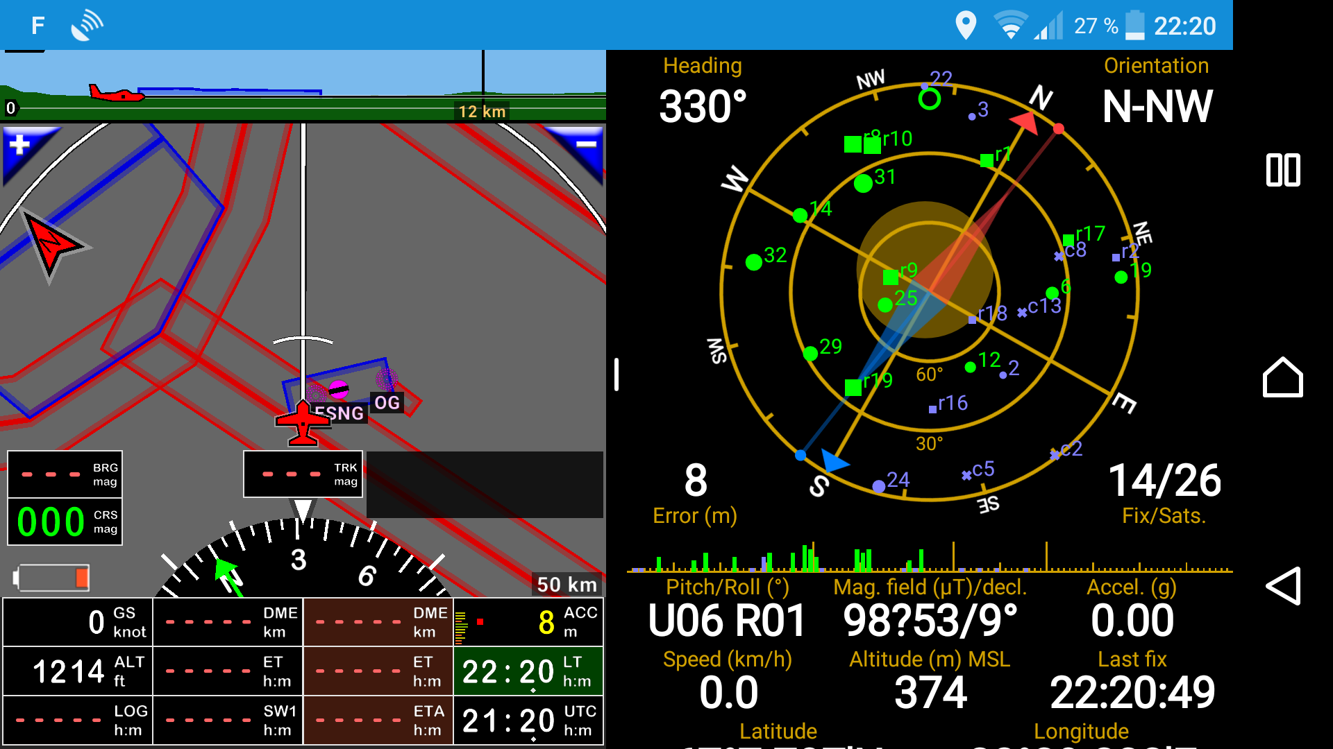

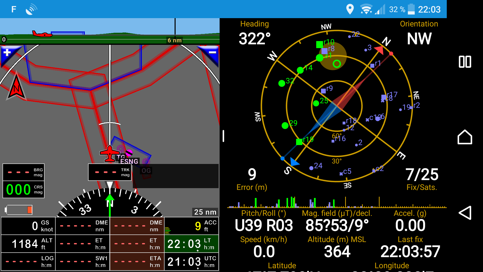

You can see in my first attached picture, with fif and GPS Status side by side, that both has an acc/error of 9 (I'm indoors). But fif gives 9ft while GPS Status gives 9m.
But if you have a look at my second image where I have changed the distance unit in fif to km (acc in m), you can see they still have same numbers, but also same unit
For comparison, fif in NM (acc ft) and GPS Status in ft
All pics are screen shots with split screen and the apps running simultaneously.
Same happens with Oruxmaps as the comparison app.
Something doesn't seem to work as intended
