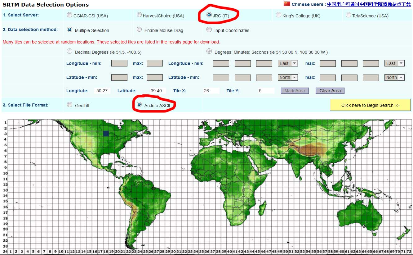

When importing elevation data, application write Bad header.
This is correct header of .asc file (values ncols and nrows must be 6000)
ncols 6000
nrows 6000
xllcorner -85
yllcorner 25
cellsize 0.00083333333333333
NODATA_value -9999
Solution:
When downloading terrain data, setup download page like it is described on attached picture.
http://srtm.csi.cgiar.org/SELECTION/inputCoord.asp
