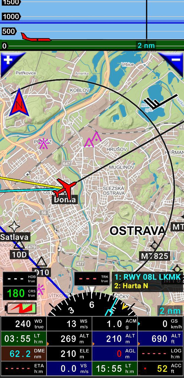

Please is at your LG G5 working the vertical cut - I mean the window at the top?
Anyway I added wind support, you can see the wind arrow...
