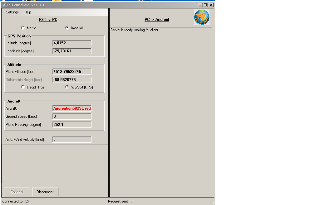

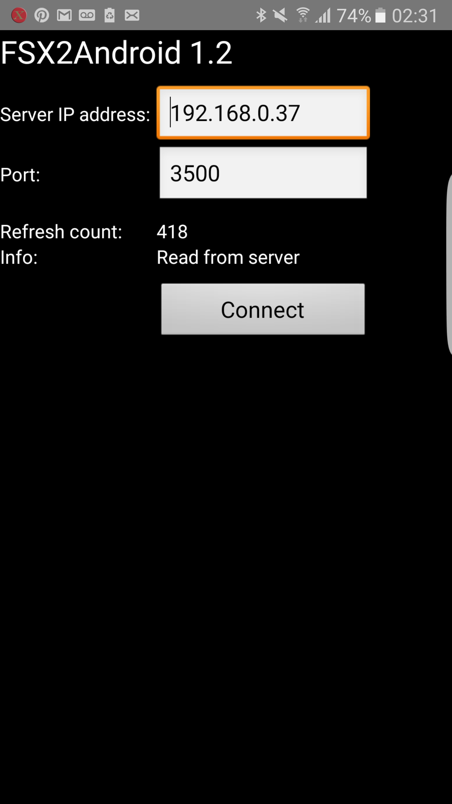

Hello, I bought FSX to android a few minutes ago, but I can use it yet. I have some problems, I really dont know what happen.
my pc is windows7, it has .net framework 4.6.1 , FSX SP2.
In my mobile SAMSUNG GALAXY S6 is installled the version client.
I dont know what means Any application using GPS. Must I download any from PLAYSTORE?
my PC and Android device are in the same network.
ok, I open the server FSX2ANDROID.EXE.
the ip address is right to both PC and android device.

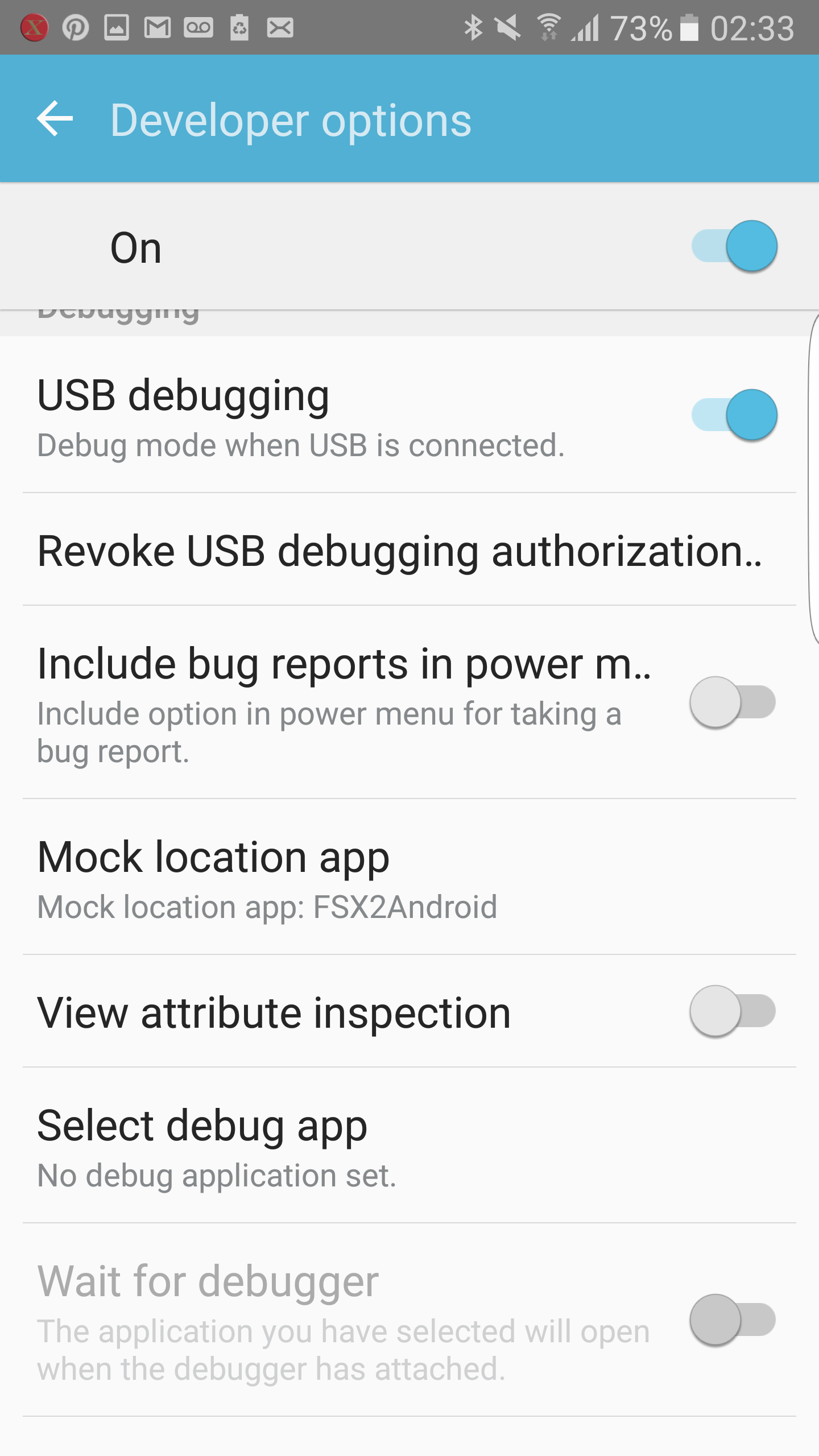

I activated the mock location app for FSX2ANDROID in my cellphone.
finally I press connect without connnection, I cant see GPS.
How can I solve the problem and use the application.
I send to you some pictures.

It looks you have the same my problem.
Looking at your pictures FSX2Android is working (communicating) correctly with the PC. Your navigation app is not updating the position because when you switch to the navigation app you put FSX2Android in background and it stops the communications.
I have a Samsung S7 which is able to show on the screen two apps together: I put both the FSX2Android and Navigation app together in order to be both active at the same time and everything is working!!!
I hope the developer can fix the issue and let FSX2Android communicate also when in background.

Hi, did you alllowed mock position in Android settings?
