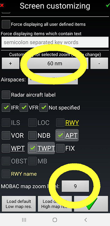

Postby kitercuda » 29 Jun 2019, 08:13
Version 22.50 supports MBTiles maps.
Copy your xxx.mbtiles to .../Maps/MBTiles folder at your Android device.
A lot of aviation *.mbtiles were created with zoom level 9 and more. So if you use the default FIF settings you do not see the map with FIF zoom 40 and 60nm.
If you want to see map (zoom 40, 60nm] long press compass rose for screen customize, roll down and and press button "Load default high map resolution" . But this button - set all screen settings to factory deafult. The second possibility is set zoom level manually - for zoom level 40nm and 60nm set MOBAC zoom level 9.
Warning - if the graphical card at your device has not enough memory, it can cause application crash - out of memory.
