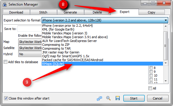

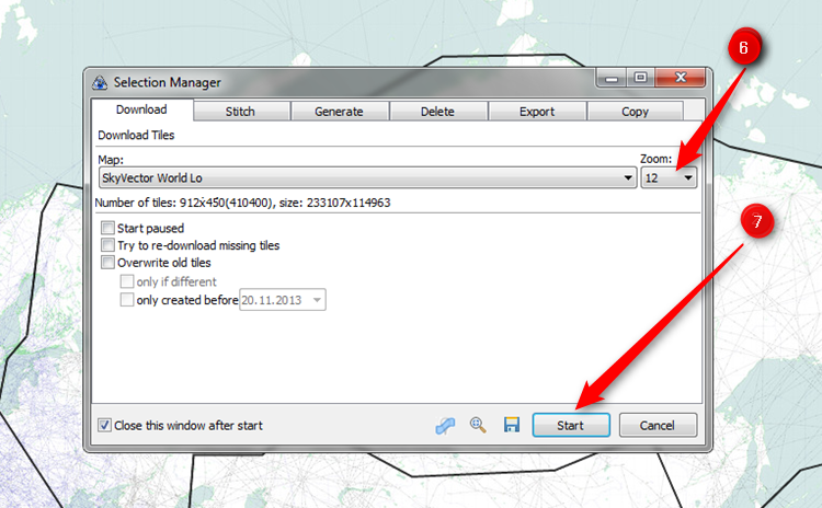

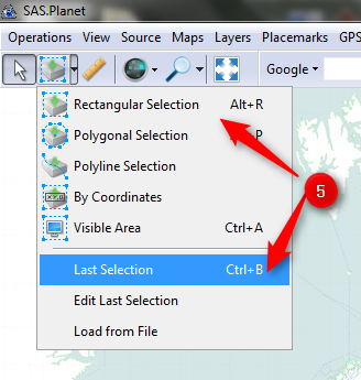

Postby Onuff » 20 Nov 2013, 17:32
Look pictures
or video
http://youtu.be/7KnCiXjv-Tw
Re: Creation of cards for the FIF from SAS.Planet
Postby Onuff » 20 Nov 2013, 17:34
next
