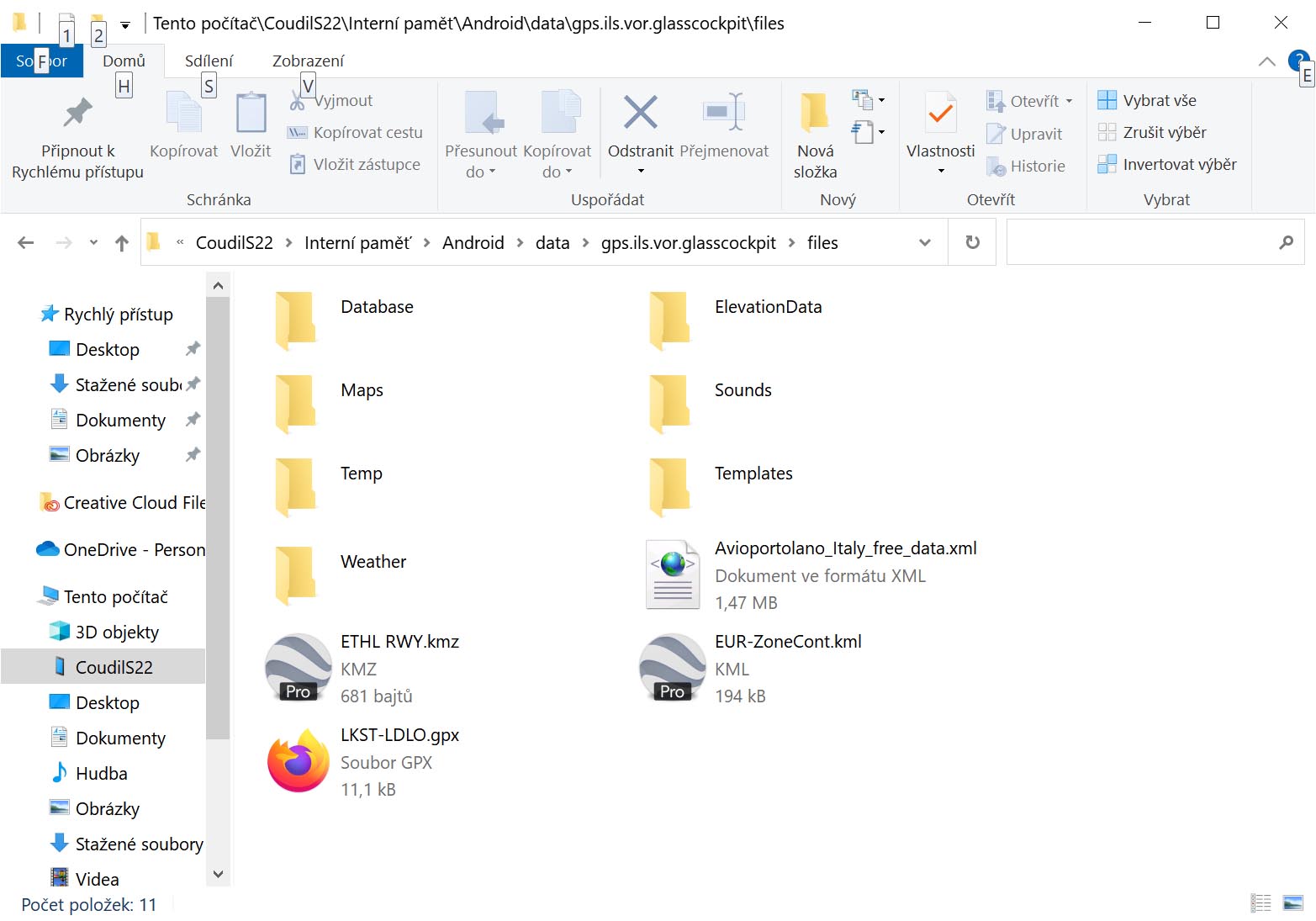

Google makes more and more restrictions. If yoo want to copy your files to Android device, connect your device to PC and open Windows file manager and copy files to
...\Android\data\gps.ils.vor.glasscockpit\files
