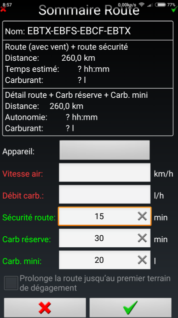

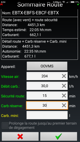

Postby RogerF » 20 Jun 2018, 08:53
1) Snapshot1: an almost straight route EBTX-EBFS-EBCF-EBTX produces 4451km:22h;662 l fuel in the summary.
2) Snapshot2: after adding/removing points in the route, the result is calculated correctly.
3) The aircraft selection is lost every time I exit the "route summary" window.
Workaround: select the aircraft with a long press in another menu.
4) How can I insert an (existing) waypoint in the route from the map display?
I tried to click the point and to press the (magenta) "Route" button to add the point, but this button does not do anything.
Only the other buttons (NAV1, NAV2, PDF) are working.

Route summary (huge values) + question on route edi
Postby RogerF » 21 Jun 2018, 07:36
@Tonio: no, I cannot understand why I get a distance of 4451km instead of 260km and why the distance suddenly becomes correct later. Please explain.
I reproduced this error today: I think that it is linked to the import of the route (in gpx format) .
Also what about questions 3 and 4?
Re: Bug: route summary (huge values) + question on route edi
Postby Tonio » 21 Jun 2018, 11:41
Hi Roger
Your points 1 and 2
Route summary could be called in 2 different modes
Mode 1 – Edit modeRoute is NOT active
In this case route summary provide information on the route itself.
Distance shown and associate information start from the first point of the route up to its last point, including eventually additional info as wind, alternates airports …
Mode 2 – Active modeRoute IS ACTIVE
In this case route summary provide information that is slightly different
Distance and associate information shown start from aircraft position, to first active point of the route … then up to last point the route, including eventually additional info as wind, alternates airports …
If you are outside with GPS active and a fix, you will see it
What if, if you are in active mode, without GPS fix
GPS provide then N 00°00’00” W 000°00’00” position that is somewhere in the middle of Guinea gulf.
FIF take then this position as aircraft position. That's why you get a total distance with thousand of miles or km
You see, not a bug, and I had similar results with most of application I tested / used in the past
Could I suggest in your title modifying “Bug :” with “Question concerning”
