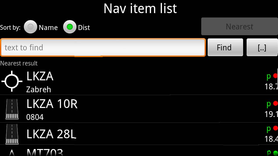

You are flying and you see airport LKZA at the map and you decide to lend here.
Long tap at LKZA (until device start vibrate). Then Nav item list will appear.
Long tap at LKZA (until device start vibrate). Then context menu will appear.
Tap menu item PDF and you can see this:
