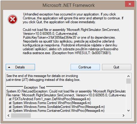

Hi, I am not able to install server zip file, having same error as bigdatapimp. It would be nice to get my paid version of the app to work with fsx/P3D, so I can practice airspace awareness in conjunction to the real world.

I also have same problem running fsx2android server on Win10 with Prepar3d.
Is it incompatible?

Server side solved.
By reinstalling the SimConnect.msi from location Program Files (x86)\Lockheed Martin\Prepar3D v3\redist\Interface\FSX-RTM\retail\lib
I'm now able to start the FSX2Android.exe server. (Seemed like the GAC wasn't registered correctly, GAC MAnager).
In the server window right side it says "Server is ready, waiting for client".
I now receive the correct GPS positions from Prepar3d in the server FSX2Android app.

I get the same error message of bigdatapimp (see above).
I have Win 7 64 bit, .NET Framework 2, 3.5 and 4.6 installed and MS FSX Steam Edition: may be the problem is with the last one?
Thanks in advance for your help.
Daniele.
UPDATE: solved. Same solution as micke.

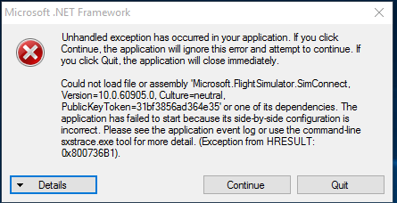

Postby yair1956 » 07 May 2017, 23:14
It is May of 2017
Just downloaded the server (Win10-Pro) to my reg, trying to run the installer and it crashing from the same reason.
Any ideas ???
Tnx in advance
